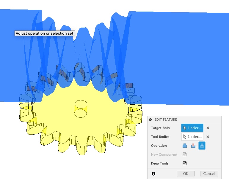

The path is the large circle. The smaller circle will be used to extrude the worm so this is where you experiment with overlap etc... I only go half distance because Fusion will throw an error if I go full circle. Twist angle is 360 divided by the number of teeth so that they match later when you do a circle pattern of two.
You can then do a combine cut to carve the worm.

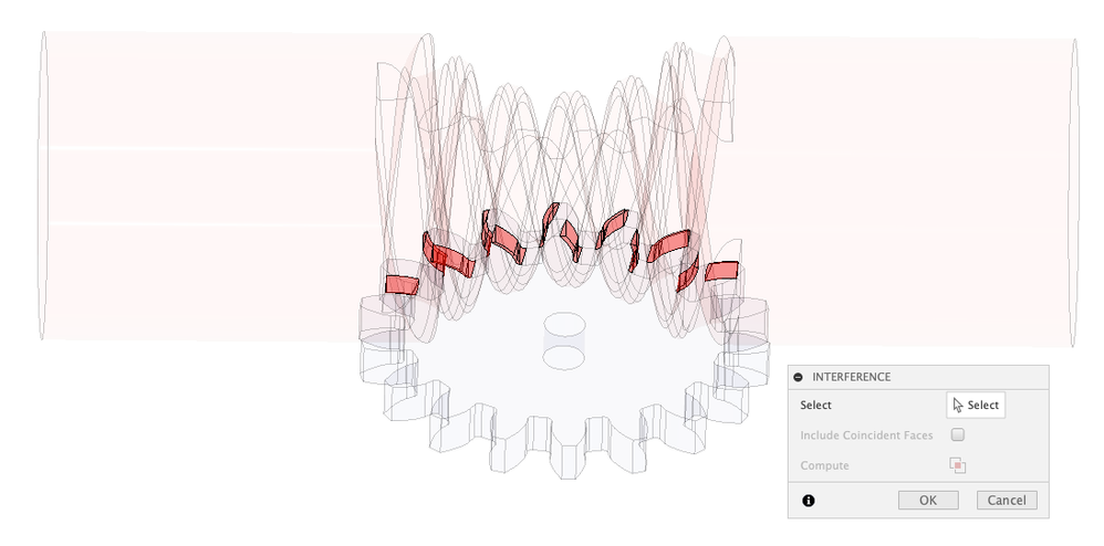

There is still a bit of work to doo. There is interference between both parts.
 So the next thing to do is a combine / intersect, keep the tool and create a new component containing the resulting bodies.

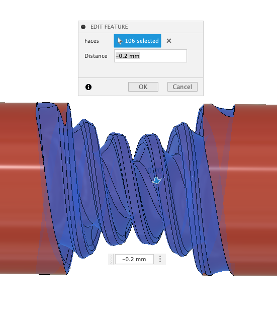

 At this point all is left to do is add some tolerance. I opened the Offset command and widow dragged over the worm to select all carved faces and did a negative offset of the amount of tolerance I thought made sense.
Thats it!
