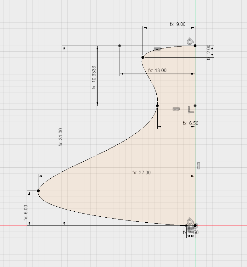

trying to create an object of which i can control the shape via splinepoints defined by user parameters.
so i start by defining some points until everything is fully defined, i can now control overall width and height and the position of 3 points with user paramters :
and then draw a spline through the points:
.. still all looks black and fully constrained/defined so i mirror it, i made sure the spline has a tangent constraint to a horizontal line on the top and bottom:
.. all looks as intended, still all black and fully constrained/defined. BUT when i adjust the user parameters the symetry is lost:
I was kind of expecting the mirror to be .. well, a mirror .. shouldn't everything after the mirror be the same ... not sure why things go out of shape, what did i forget to constrain ?

I recommend that rather than mirror the spline - you mirror only the points and then create one closed spline connecting the points.

@TheCADWhisperertheres other things in the file so i can't share. but mirroring the points does work so many thx for that 🙂
here's a quick example i did which exhibits the same problem:
sketch is fully defined and i think i have constrained everything as i want it to behave when i change parameters, if you play around with the user paramters you'll see how it goes out of symetry.
http://a360.co/2Fn21Qo
