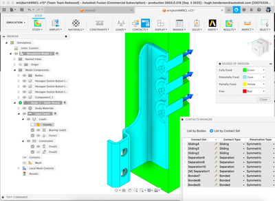

I had a similar idea @bwalker145, and gave it a whirl. The reason there's only 1/2 the model showing is to take advantage of symmetry, and we can add a 'frictionless constraint' to the faces created by the cut (and the face in contact with the bolt sleeves). I didn't model that portion and used a Bearing load instead, which will only push down on the hole in a parabolic load profile, but will also not pull down from the top portion of the hole (not reality) as a conventional Force load would. The dummy mount also doesn't take into account the same compliance of the real structure, which likely has a bit more deflection.
Contacts setup - DOF View - Potentially Fixed bracket group.png  Above 50 MPa Equivalent stress.png

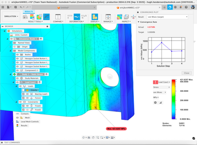

I enabled Adaptive Mesh Refinement that will automatically detect the area(s) of highest stress, then automatically refine the mesh in the local area, and does a wash, rinse, repeat iteration until it converges upon a stable value. i.e. it's one way to check the numerical result is likely not mesh-size dependent.
Max stress - convergence plot.pngHalf symmetry model - Von Mises.png5x super exaggerated Deformation - side view.png

I hope this helps illustrate a few approach options in the setup. In my example (F3z Fusion archive attached below) I could have made a major blunder and offer no guarantee it is correct for the real-life loading conditions, etc. <caveat emptor 🙏>

By using the backing plate and a Separation contact, the video & screenshots illustrate how it allows the bracket to 'peel away' from the backing plate to be consistent with real-life. I found it's sometimes deceptively tricky to set up just enough constraints that will allow the natural free movement (as close as possible to actual with the 'tools provided') versus a falsely over-constrained setup. Worst case it could lead to generating the correct results for a different problem.
For a single body study, Frictionless may be the appropriate choice. However, a Separation contact in an Assembly context would be the way to approach the setup IMO. Reason being is Frictionless allows only sliding (tangential movement of the nodes with respect to the face normal at that point). As such, it locks out not only the penetration effect (good) but simultaneously locks out the separation effect, which may become a factor to consider if the load magnitude reached triggers the effect.
