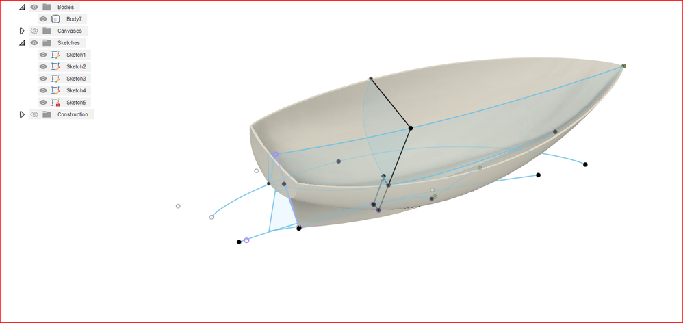

I am trying to make a model of my boat. I have the top view with lines, a side view with ribs and a front view with ribs.
I have aligned the images up, and made sketches of all the ribs and used the move tool to move them to the right X, Y and Z positions. The model looks good, but when I try to use the loft tool,  and use some of the sketches as rails, I get the message the rails dont intersect with the ribs.
How can I get the sketch lines from ie. the X axis to join/intersect with those drawn on Y and Z axis?

When editing the sketch, it's Create > Project > Intersect.
Then you connect the purple dots.
You should consider less ribs and water lines, until you have a smooth hull skin, then populate the ribs in that shell for accuracy.

@denhaanj Please upload what you do have, prefer not to start from scratch.
Stumped at the stern as the line drawing leaves no thickness at base of the keel, and the rudder top view is missing, but even so, two lofts, and an extrude as visible at the moment.
Might help….

davebYYPCU
No problem,
presume the base keel sketch should extend to trailing edge of the rudder.  Had a similar problem as your thicken, with the transom, but there are many ways to skin the cat.
Might help...

davebYYPCU
For a desktop model, size unknown, the canvass will do nicely, despite the obvious errors.
Aligning the canvass takes a bit of practise.  Using it as a guide, take the longest curves as accurate and build outside > in.
Project > Intersect is your bread and butter.  Collect existing references into empty sketches, and then snap to the purple articles.  They are consumed as you build the sketch, sometimes become black.  Keel outline rail sketch used in the loft is a perfect example.  Two purple dots and a line.
