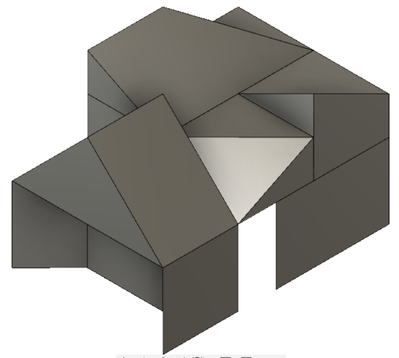

How to form skewed surfaces?
jkajiyama
What I have so far.What I have so far.Sketch to be copiedSketch to be copied

shahriarsifat1802164
In this case, you can easily make a required plane on the top surface with an angle >> make some required sketch >>loft the sketch to the top of the body.

jkajiyama
Here is my f3d file. I hope you can teach me how to make skewed planes/surfaces.
Message 6 of 17
jkajiyama
I am having trouble recreating the sketch that I have in 3D because of the presence of the skewed surfaces on the back segment of the sketch.
Back segment of the sketch I want to recreate in 3DBack segment of the sketch I want to recreate in 3D
Back part that I have so farBack part that I have so far

johnptc314159
in design mode you can create construction planes that you then select to sketch on.
you will find it under the construct tab.............make a plane then start a sketch on it. 🙂

davebYYPCU
I was not able to complete the model to accord with the 3 views,
but my most logical version ended up with the same top quarter view as yours.
Your model would create a solid line in the top view that does not exist, and
both of us do not address a hidden line in the front view.
Take the front view lines from top left, to mid point on the right -
the lower half of that line goes where?
If we delete that hidden line, I can finish the model, with 2 surface panels.
or loft that line to be non planar, and not be in the scheme of things.
I am 5 hours from a desktop to follow up.

jkajiyama
 Hello everyone, sorry for the late response. The solution that worked for me was constructing an angled plane and sketching on it, the sketch will then be lofted on a flat surface directly below it. that process resulted to this 3d model.
While building the model, I realized that something about the reference is not right. This is the reason behind the difficulties while transferring the sketch to fusion360. Either my isometric drawing is incorrect, or the multiview projection given by the instructor is not possible in the first place (and yes, this is a university assignment).
That is my own problem now as it is not included to the scope of my initial question (skewed surfaces), but thank you for everyone that tried and pointed out errors in the material given by my instructor. I'm an absolute beginner in fusion360, thank you for your patience.
