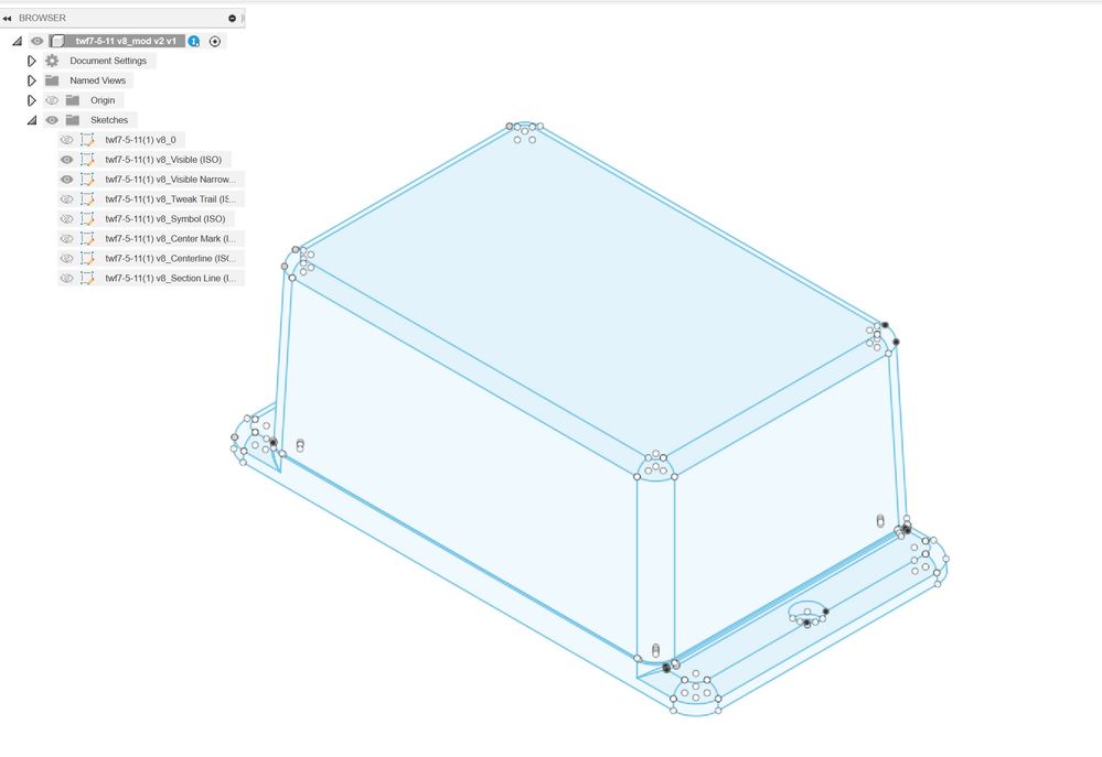

Warmingup1953

g-andresen
I see views of a imported drawing*, where the scale of the elements is not known.
Of course, it is difficult to get something useful from this.
günther
* no sketches for extrusion, sweep ...
