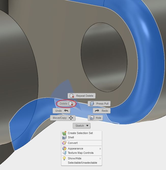

In latest update there is a way to simplify models for simulations by deleting fillets, faces etc. but I can't see the option to export model after that. Is it possible to export to stl. simplified model?

The simplify workspace is only accessible from the inside of a simulation study so as far as I know, Exporting is not supporting yet. But you will be able to clone the model inside Simulation.
As of now, If you want to get as a model, you should modify it in the model environment with the Delete function.
