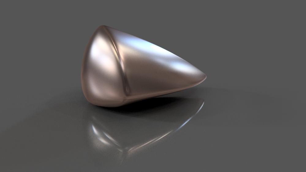

This is a deceptively simple design and lofting would usually be the right approach for arbitrarily curved surfaces.
However, what makes this challenging is that the only way to design this reasonably easily with lofts is to loft into a point which is not ideal. IN this case all three of the main surface lofts are into a point and that already makes this very challenging.
Then, the rear loft transitions from a crease up top to tangency at the bottom when mirrored.
Basically you'd have to fillet all edges in one go to make this successful, but that doesn't work.
I recreated the shape using T-Splines (Forms). The process how I created this might not be self explanatory. If yu think it can help you, I'd be happy to create a screencast.
