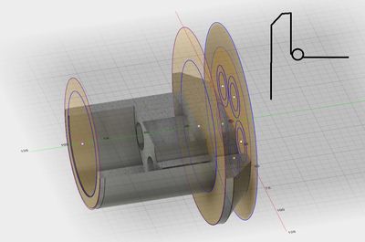

This has been driving me nuts for a few nights now.
How do I create a radius at the corner as shown in my painting? I was thinking to sketch a circle, use dimension to position the center of the radius below the outside diameter, then revolve it around, and fill in the gap that would be left somehow, but I can't select the "body" (If thats what it's called" I don't have any CAD experience except for playing with this for a few days.
Any help would be great,
Ed
PS: How can I change the view to show the extruded holes in the center of the part as dotted lines in the 3D view?

Excellent!
But my the center of my radius isn't quite equal from the two lines I drew.
The center is 4mm from the upright face, but only 2.5mm from the horizontal face, so I need to drop it straight down 1.5 mm, if that makes much sense.

bigeddymachineshop
Thats the ticket!
But how do I roll that into the 3D part?
I can't select the edge of the round extrusion because its not a "line".
Is it easier to sketch the whole part 2D, then revolve it to make it 3D?
