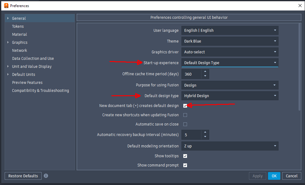

You can set Fusion to work pretty much as it used to with these settings.
