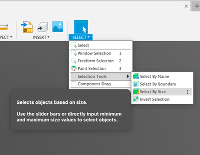

We have these complex PCB assemblies that have every single component modeled out. When we bring them into Fusion360 it is painful to use them at all. The suppliers provide them as STEP files - with all of the individual components. We want to put them in our assemblies - as a purchased part. What want the detail so we can point to things in the assembly but we don't need each individual component. What would you recommend to consolidate all of these parts into something that is more useful. Right now a single part will make the entire system unusable.
Joe.
Message 11 of 19
TrippyLighting
This is an issue that comes up not often, but regularly.
Not knowing the exact nature of your PCBs I can only make some general recommendations.
The best thing is actually not to bring a PCB into an assembly but to build the assembly around the PCB, but that is always an option. Moving a PCB assembly with thousand(s) of components into place is very slow.
As such before inserting the PCB into the assembly there are a few things that can be done o ease the pain.
Usually in a mechanical assembly, passives on a PCB are irrelevant. If you don't need them, delete them. Fusion 360 allows a selection by size:
Before using that selection, set the selection filter to components, so Fusion 360 does not just select the bodies in the components, but the components. That helps greatly in deleting all the unnecessary small stuff.
Don't forget to set the selection filter back 😉
If you need to keep all components, you should at least hide all those you don't need using the same process as described above. However, instead of directly hiding the components, first, create a selection set, and hte3n hide them.
If you have to see them for reference, then at least set them to unselectable.
