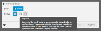

In the tutorial I used a few other software packages to get to an end result. I used InstantMeshes to re-mesh the objects. By now Fusion 360 has a built-in method with the organic mesh conversion. This requires a paid subscription:
However it is rather slow and there are a good number of other options that can help. ZBrush and 3DCoat have industry leading re-meshers. Blender has a marching cube and quadriflow remesher. I belive an InstatMeshes plugin exists for Blender. The Lab tools in SideFX Houdini also include InstantMeshes.
Remeshing complex, triangulated meshes is really the latest and greatest method to covert complex triangulated meshes into solids.
