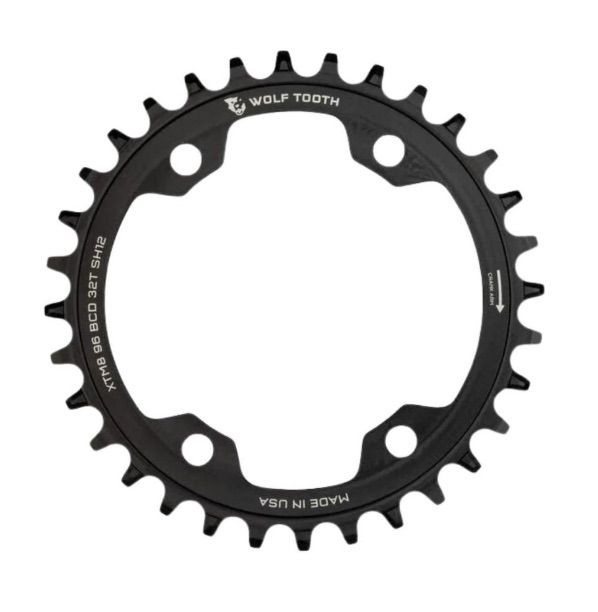

Warmingup1953
Do you mean what I call the Chainring?Wolf_Tooth_96mm_BCD_Chainring_Shimano_12_Speed_HG__XT_SLX_Drop-Stop_ST_32T.jpg
andreas.scheucherautodesk.hobby
Exactly! Yes, you are right. Chainwheel was the wrong therm. Non native here...
Though your's is even a special case, as it's a narrow wide chainring.
