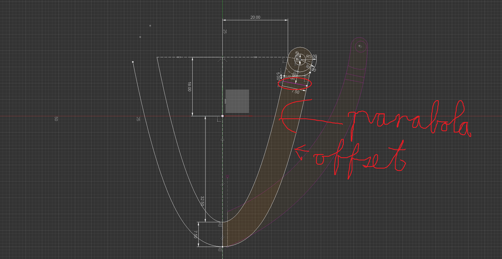

I am working on a mini toy crossbow when I encounter this issue. I tried different ways to constrain a line so that it is normal (perpendicular to the tangent line) to the parabola and/or it's offset curve such as creating a tangent line on both curves, set a coincident to both ends of the line and setting the length to the offset distance and directly using perpendicular constrain, but all of them returns with an error.
I also need  to set a distance between the line and the center of the circle.
The line in question is the unconstrained oneThe line in question is the unconstrained one
Since I taught myself how to do everything from CAD to production I think I must have erred in some way. Yet I am running out of time in this summer vacation so I put this in design section instead of the report bugs one so I can find ways to do it instead of pointlessly arguing about the problem.

Like either one of these? I didn't know whether you want it perpendicular to the regular line, or perpendicular to the dashed construction line, so I made both.
You are confusing me, by the way. None of those curves is a parabola. They are all constant radius, and a curve of constant radius is called an arc. Also, any line that is normal (perpendicular to a tangent line) to an arc must pass through the center point of that arc, having zero distance between itself and that center point.

Sorry I didn't make it specific but the two "lines" on the side are not straight lines but a part of a parabola, I want to make it a normal line so that I don't need to change the angle of that line (which is for making a hole for the bowline) if I want to change the bow shape again.

Good luck with that. F360 lacks the ability to constrain things tangent to any irregular curves. Don't get me started. And if you can't constrain anything tangent to it, then you can't constrain anything else perpendicular to the thing which isn't tangent and expect it to be normal to the curve.

Place a point in the center of your line, then draw a line from the line center to the circle center. Then you can make your line perpendicular to the center line.

That looks close, but it won't actually make the line normal to the parabola. Go ahead and drag the line down towards the bottom of the parabola. You'll see.

Thanks for replying to my question, in which you gave me some information for me to find a "close enough" solution myself. But would you kindly post the f3d for that file, I only keep it unsolved because I think someone will find it useful later on and I have already used the circle method to finish my job.
My Solution:
I made a construction line on any 2 points on the curve, then I set a very short length for the line. The line should be quasi-tangential so the line perpendicular to it at the midpoint should be quasi-normal as well
