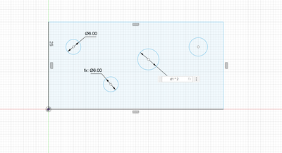

All you need to do is link up the dimensions of the bodies you want to be the same to a single defined dimension.
It doesn't matter if they are not the same "thing", you are using a common dimension for it.
Set your primary dimension, in this case d1, dimension your next object but instead of entering a value or hitting
enter, click on the common dimension. Now the second dimension will change every time you change the first
dimension. If you want you can also make other dimensions dependent upon a dimension by maybe entering
a formula like this.
Other dimensions can also be driven off these linked dimensions.
So using dimensions and parameters are fairly straight forward.
