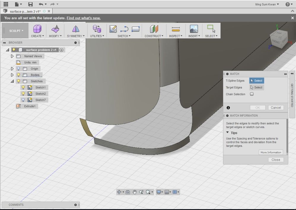

hi guys, since I am frustrated on making continuous(curvature continuity) "y shaped joint surface in solidworks, and I heard that in can be easily done in Fusion 360. I just start learning fusion 360 and could anyone solve my problem? What function should I use for doing this type of surface?
Many thanks!!!
Public link
http://a360.co/2oQ6ohM

It looks like you already have a surface. In that case your would likely use the Patch workspace, maybe a loft.
Attempting to get surface continuity by patching a T-Spline to existing surface patches is likely not going to work well.
