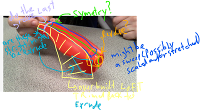

How do I model this component with surface modelling?
g_rugierobishop
I need to model this drone shell using surfacing modelling. I'm new to fusion 360 and have never used surface modelling before, so I'm unsure where to start and what tools to use - could anyone help?
1,150 Views
9 Replies
Replies (9)
Message 2 of 10
laughingcreek
hard to tell details from the pics.  a few thoughts-
look for the obvious and easy first.
is this symmetrical?
can anything be revolved or extruded
can anything be swept?
can lofts be formed in a reasonable way (4 sided, not to crazy), should they be over built and trimmed back?

Message 5 of 10
g_rugierobishop
These are the two projects I have done before, one of them is the drone I am currently working on.
I feel pretty confident modelling most complex shapes, however I am not familiar with surface modelling. Surface modelling is what is required to model this shape according to my teacher, but do you think it is possible or more feasible without surface modelling?

Message 7 of 10
g_rugierobishop
Thank you! I see I could do it this way, but I have been specifically asked to use surface modelling. This helps either way though, I appreciate it.

Message 9 of 10
laughingcreek
everything in my picture was about surface modeling.
