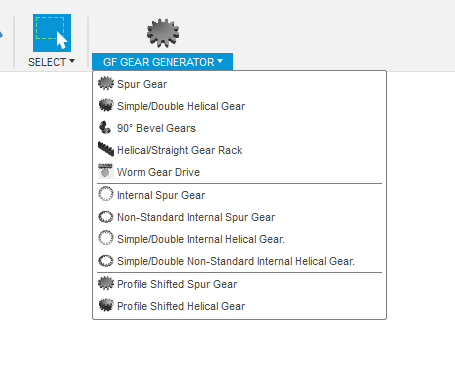

Hi
I downloaded the GF Gear maker and installed it into Fusion.
I can make basic gears but I am having trouble making an accurate Gear that fits the process I am working on.
Its going to fit on this B9 project. Its a basic area where a torso will rotate on a curved base using a lazy susan that will have a Spur gear with a motor attached to it:
The outer diameter of the internal spur gear needs to be 450mm and the internal diameter needs to be less than the inside of the lazy susan diameter which is 388mm diameter so the cogs are clearing the lazy susan.
When I select the internal spur gear option:
I choose the Internal Spur Gear. Which gives me this screen:
This is where I do not know how to get a internal gear that is 450mm outer diameter and less than 388mm diameter, 6mm thick, with say 50 teeth on it.
If you could help that would be great. I really don't understand how to get this right and my attempts make it really large.
I have attached the basic fusion file I am working with. Body 14 is the sample lazy susan size.
