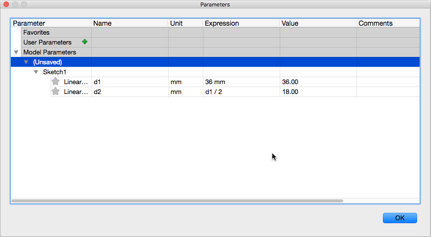

Another simple way to use parameters is take a look at the parameter name, in this case the dimension "d1" is the parameter name for this first dimension
You can create equations right in your input fields referencing the parameter name, without having to go to the Parameter dialog.
here is a very simple example where the height dimension is set using an equation referencing the first "d1" dimension (notice the prefix of "fx" in the dimension, indicating an equation/parameter is used)
So this is all in canvas interactions you can do, because the inputs of dimensions are captured as parameters, d1, d2...
And if you look in the parameters dialog, you'll see these equations and relationships are captured and can be edited here.
The more complex the relationships become the easier they are to manage from the parameters dialog, but if you're doing fairly simple relationships (as in this very simple example above) you may never need to use the parameter dialog, even though you are creating parametric relationships.
