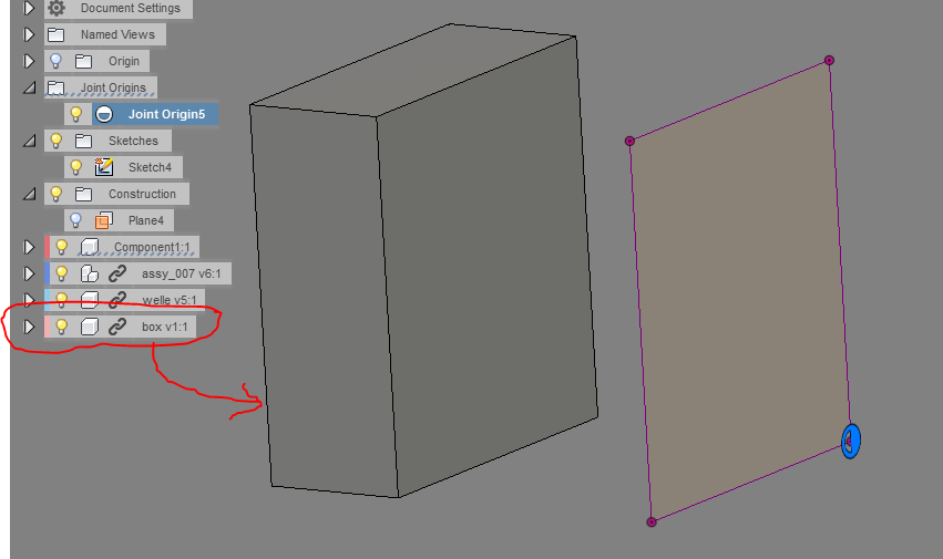

1) I inserted a linked component  -> "box"
2) created offset plane -> "plane4". And created a sketch on that plane -> "Sketch4"
3) projected the box-face on the sketch
4) created a joint-origin using the sketch -> "Joint Origin5"
Then I tried to create a joint. Couldn´t select "Joint Origin5". To me, this is no surprise because plane/sketch/joint-origin went into the root-component. I was able to select the usual joint positions in the linked component box - but this is also not a surprise, just "as designed".
What did I miss (or misunderstand)?

daniel_lyall
Dont worry about what I said it was more directed to jeff any way.
Its put the joint origin on what is the part that is being added to as in, part 1 being joined to part 2 you put the joint origin on part 2 so part 1 joins to part 2 on the joint origin.

aaahhh, I just noticed the correction in jeff strater´s post #10. Thank you @jeff_strater for this clarification, my confusion (foreign-language and Fusion issues) is vanished now. Big sigh of relief from here.
