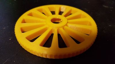

I've just started learning Fusion 360 and want to print out this basic cog. The main thing i can't figure out is how to get the teeth to go all around the edges, I'm guessing i need to use the revolve tool but i just can't seem to get it right?
Also similar for all the arms in the center im guessing it's just a cut and revolve but i can't figure it out 😞 The center hole doesn't need to be anything more than just a hole.
Any help is appreciated! thanks

Sketch one tooth, extrude then use a solid pattern.
There is a gear script, look at the add-ins  (Shift+S) don't know if this is what you're looking for.
Also you might want to try this tutorial and some of the others.

Circular pattern is your friend. Here is one way to solve the task:
