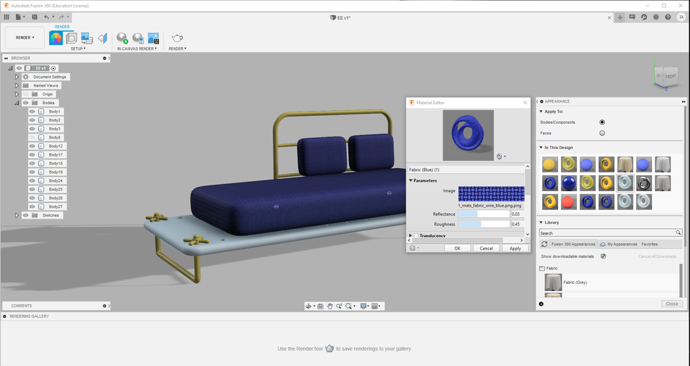

I have a specific colour that I want to use for my couch design but it seems the fabric doesn't have the colour feature on edit tool.

If you look carefully the fabric color comes from an image that is used as a texture - you can replace that image ! you can find online any texture of fabric for 3D renderings and bring it in 🙂 you can also tweak the image colors (for the textures you find online) and use them after tweaking 🙂

Yes! the internet is absolutely filled with them - some free some obviously cost money 🙂 - search for 3D textures for rendering - a lot will come ready for PBR type of texturing - that is a set of inputs that will determine the rendering of a 3D object - some of the PBR options are available in the appearance settings of a material - here are some links:
