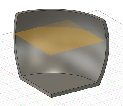

I have 1/4 of a pot. I am trying to remove 2 cylindrical shapes, 1 on each end. I can set the size properly and do the 2 cuts, but how do I make sure the 2 cylindrical hols are at the same height (same z value)?
Hope the attachment shows what 1 needs to resolve this.

You can Project the height of one to the other
or
Circular Pattern
or
use dimensions.

The first thing you need to do is to recreate this geometry for a cleaner path down the road, as it only takes 2 minutes.
To create both holes at the same height, create an offset plane, create a sketch on it, then inside that sketch use the intersect tool with the faces of the holes selected, and that would give 2 intersection lines exactly the same height as both are on the same plane, then create a sketch on each face of the holes, project the intersection line and use it as a reference for the hole sketch circle center.
Find attached the .f3d file for you to review.

Thanks! I think I got them, will study them. If confused I'll be back.
