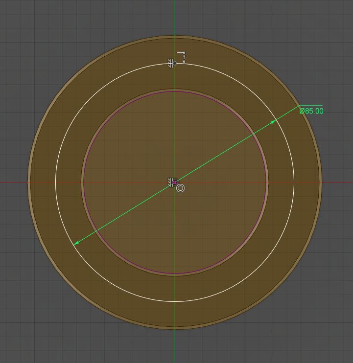

Like the screenshot shows, I did create a hole feature with a sketchpoint reference and made a circular pattern together with a chamfer and thread feature. When the pitch circle diameter has been changed to 90 it losses its references and shows no selection ("Circular pattern 1 hole PDC90 lost ref"). The hole pattern stays at the PDC85. If the "From Sketch (multiple holes)" option is used it seems to work and remembered it's single sketch point reference. Do i use the wrong workflow ?
Also it would be nice to see some small enhancement in the hole feature like chamfer options at all edges of a Hole type. Thereby an option to create standard center holes with this feature, which would be common at turning products.
A small improvement for the thread feature would be the appearance of the thread's lead in and -out if a chamfer to a hole is applied.("Thread feature chamfer")

The reason the holes circle dimater does not change when you increas the size of the sketched circle is one of these two:
1. The sketch point you made is not coincident with the circle.
2. The hole is not coincidet with that sketch point.

The sketch point is coincident with the pitch circle at the sketch using constraints.("Coincident sketch point")
Like I mentioned before, the placement selected at the hole feature seems to make the difference. If "at point" is selected, it snaps at the sketch point but no reference is shown and made. So it's lost if the PCD is changed inside the sketch. If the placement "from sketch" is selected it stays referred to the sketch point. Did I overlook an option to make the hole coincident with the sketch point ?
What strikes is a modify to the hole feature. It isn't possible to change the placement selection after the feature is applied. The way to change the placement afterwards, is re-applying the hole feature. The referred features to the hole feature will be lost then...

It seems to me the method for placing holes in particular modifying the placement after the hole is created is bugy ot lets say not fully thought trough.
When I place the hole initially by selecting the sketch point it creates a constraint that is not visible in the viewport. the only indicaion is tht "Face/Point" ches to "1 selected". But it dies that also if there is no coincident constraint created with the sketch point.
If you do decide later on to edit the hole location because pehaps you don't want it constrained with the skech point anymore the "1 selected" can be deleted but then I fait to be able to select any other point ot the sketch surface for hole placement.
Either I am also overlooking something or there is simply someting left to be desired.
