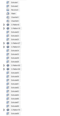

I've been modeling a pretty large design with design history turned off, because I find that it tends to be easier to handle in the long run. I'm running into an issue where there's a massive list of operations that I've done in a component, with seemingly no way to hide them. This makes navigating the object tree super annoying, as I have to scroll past them to get to my components and bodies and never use them. Is there any way to hide these?

Take a look at my screencast and you will see one method of handling your request.  At the end of the video, I suggest, on a different model, to use the timeline and organize it using Groups.

I wasn't aware it's possible to group operations on the timeline! I'll try to keep this style of modeling in mind in the future. Thanks!
