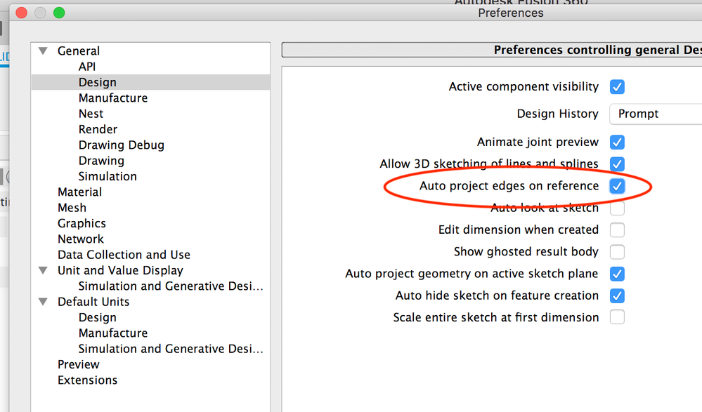

Hi @gentijo,
Can you check again whether these two settings are disabled:
If both of these are off, you should never get any auto-projected geometry in your sketch.  Also, I would try disabling the "Allow 3D sketching of lines and splines" setting.  That one will not auto-project geometry into your sketch, but can cause you to reference 3D geometry in your model.
I have not been able to reproduce this.  Is it at all possible that you might have projected these accidentally in the Project command?  If you are in the Project command, and you select a face, it will project all the edges from that face, which is what it looks like might have happened in this sketch.
If all those options are off and you are still seeing this, then there is definitely a bug in Fusion.  Any information you can capture about when and how this happens (video, etc) would be helpful.

I think it might be my interpretation of how the two options 'Auto project geometry on active sketch plane' & 'Auto project edges on reference' relate to one-another is probably out of whack. To my mind, if I am disabling 'Auto project geometry on active sketch plane' I would expect that to happen regardless of if Auto project edges on reference is enabled so I can know my own lines are in the correct XY position. ie when tracing 2D blueprints to turn into 3D solids, you want to project the reference line endpoints in a canvas dxf sketch to the cursor so you know you've hit the 2D XY point, so you have to enable 'Auto project edges on reference' to achieve that, but then you don't actually want the lines projected into the active sketch. I get why it works that way, but many times I just want to trace lines and points in a blueprint for their XY positions, the actual referenced lines themselves are typically useless as not useable (adjustable splines) anyway.
Message 18 of 21

I have both of those auto project settings turned off, but it still projects geometry in an active sketch when I use the dimension tool. That's a bit annoying, because if I have a few bodies/components visible, it can sometimes be difficult to properly dimension stuff in the sketch I'm working on, simply because the dimension tool tries to pick references to existing and visible geometry. Sometimes it can of course be convenient, but I would prefer to always have to project manually.
