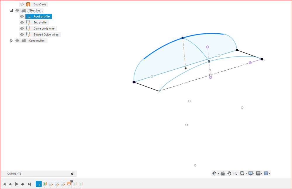

Sir.  I am getting nowhere with this drawing.   Some of the time it
reports guide rails are not joined to the arcs.  Sometimes I can select
two segments of an arc, but not the other arc, sometimes different
segments.  Now I can not select the guide rails.  See image:

Referring to v6 file.  Sketch order in the browser.
As said in message 5, I found sketch 1, behaving badly.  Making the intersecting three articles at top centre position.  I deleted the top two curves, and replaced those with a 3 point arc.  Made the end of the new arc, tangent to the outside curve.
Next fix, was 3rd sketch, front point of the rail, has lost the projected point that comes from sketch 2.
Next, 4th sketch, you should project the bottom line out of both sketch 1 and 2.  Hide both those sketches, now you can confirm two purple lines.  Draw lines for rails connecting to the end points. No white points on the outline.
With these fixes, the Loft works first time.
I find it best to have Chain Select turned off, in the Loft Dialogue.
This means you build the profile selects as you need them.
Might help….

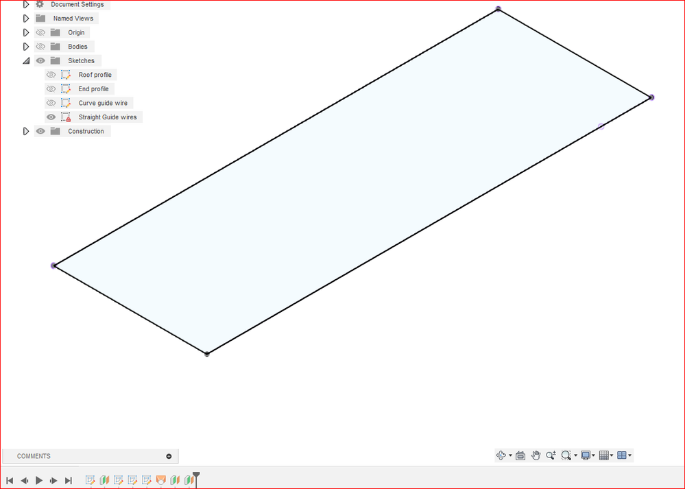

Sir.
I notice that when you select 'Edit Feature' you get the Arrow cursor.  When I do the same, I get the hand and am unable to select anything.  Unfortunately, I can not send you a screenshot.  When I try to capture the screen the hand cursor disappears.......
However, I found that I could create two new lofts by selecting the smaller arc on the roof profile, then the end profile.  That filled in one end.  I repeated that at the other end but it seems to be unnecesary by your demo, for which many thanks.  But why for you and not for me?  It is this seeming ability of Fusion to perform a task at one time, but not at another time under what should be identical conditions that is so frustrating.
Anyway, here is a screenshot showing the model after thickening.
The end profile has now been trimmed to produce a compound curve in three planes.  Many thanks for the assistance from everyone.  But, whilst my problem has a solution, I do not know where I went wrong with the surface lofting.
