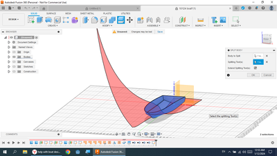

hi all,
i'm trying to build an rc boat hull in fusion and it has been kicking my butt but i've got something resembling what i want.
what i'm struggling with is thicken errors, rail errors etc almost constantly if i make any amendments, i.e im trying to add spray rails/chines and it is mega painful to say the least.
can anyone help with general advice on making this design more reliable for rails/thicken etc? i'm happy to start it again if that is better but i want to take the advice on how to make it better into the next one if need be.
i have read and watched hundreds of videos on the subject but i don't understand how unreliable some rails/thicken etc are so i assume i can be doing things much better.

jeff_strater
If you are having Thicken (or Offset, or Shell) errors, the first thing to look at is surface curvature.  A most common failure of these kinds of surface offset failures is areas of high curvature.  A Gaussian curvature analysis can usually help point those out.  Here is an example, from the surface before the Thicken in your model:
You can see that there are some areas of high curvature near the bow.  So, my first guess is that these are likely to be problem areas if you get a Thicken failure.
Second, I notice that you make heavy use of Boundary Patch here.  It is not bad, by itself, to use patches, but this feature has been known to generate some problematic surfaces at times, especially around the boundaries.  This can require tolerance when stitching, that can lead to downstream failures such as in Thicken.  I did not inspect your Stitch features, but do you recall having to increase the tolerance when stitching?  If so, that is never a great sign.  There are lots of threads here on boat design.  I am in no way an expert, but I've noticed that most people use Loft for this.  Fun fact:  The Loft feature gets its name from boat design:  Lofting a Boat .  It might be worth exploring that method - loft tends to produce high quality surfaces.  Some of your patches can be done with Loft (any 4-sided patch can be replaced with a loft with rails), but you can also loft the entire hull all in one go.
You mention "rails" failures, which I usually associate with Loft, but I do not see any Loft features in your design.  Can you clarify what you meant here?

TrippyLighting
@raptorhelicopter wrote:
I don't quite understand everything you are saying but I'll try to figure it out.
Me neither and the part ! do understand is technically incorrect!
Listen to @jeff_strater's advice!
1,. Your rails in several places to not align with the profiles.
2. Use loft, instead of patch.
If you go through the timeline of the attached model you might be bale to determine how this was built, but  I am sure you'll have more questions!

I've sussed out how you done the hull, I'm trying to get the top done now, getting there. It's all a learning (steep for me) curve as I've never used cad before so happy to put the hours in to try and find better ways to do things.
