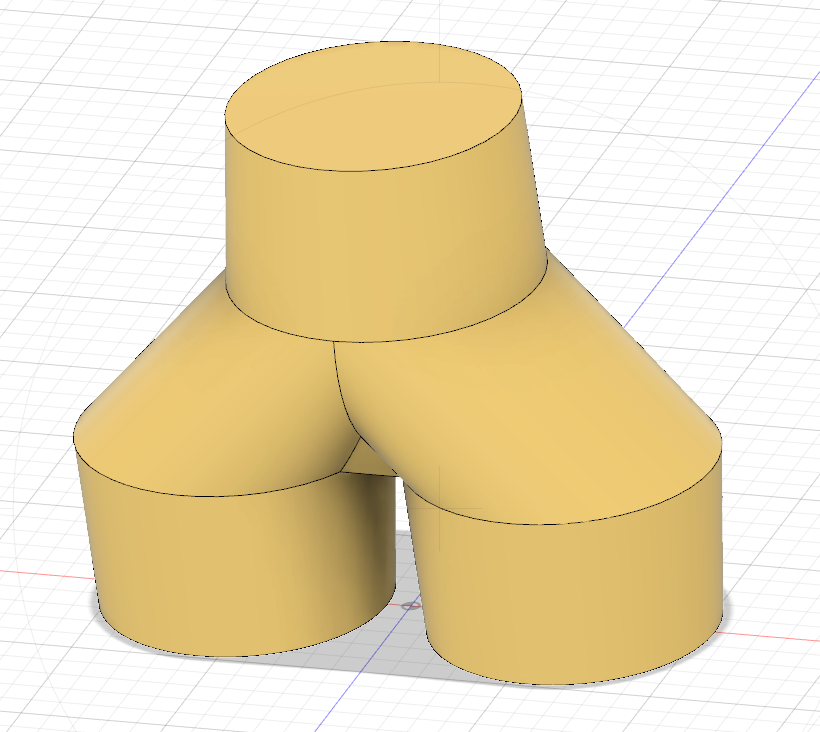

Hi!
I am stuck in trying to make a tube that branches. If have this model https://a360.co/2IyGvZD . Feel free to interact with it and even provide the timeline required to finalise the design.
Question: Why cant I turn this into solid body? Specifically, Why cant I hollow it out so that it becomes a branching circular tube?
There's a lot of thing that seems to be wrong with this model. But I am unable to determine what it is. Fusion 360 refuses to treat it as a  solid. And it refuses me from turning it into one. And the errors I got tells me absolutely nothing. Sop I am clue-less and, to tell the truth, totally bewildered and super frustrated! So please help!
As a side note. Fusion 360 uses the terms face. surface, body, solid body, extrusion, form and what not in ways that does not make sense to me? I think this model can serve as a good example of all the things that a noob like me find bewildering with how Fusion 360 treats "stuff" and how I as a designer should interact with this "stuff".
So, if anyone that knows Fusion 360 can help me with turning this body into a branching tube I will really appreciate it! And if you can also explain to me what the model, the body, I have actually "is", I may succeed better in my future designs with Fusion 360.

I bet Lars model does not include the blue highlighted "piece" of geometry. Without it it shells fine.
There's no tube but a pipe command and one if the threads outlines methods specifically not using the pipe command. You can create a Y-Branch with al three modeling methods in Fusion 360, however the best geometry you'll get NOT using solid modeling. Using the Patch or T-SPline environment will yield better geometry in this case.
Thank you @TrippyLighting for your effort and solution. It totally worked! Although I am still not sure why that piece of shell at the junction caused the problem. Or why Fusion 360 could not tell me. But you learn as you go. I just have to struggle on 🙂
