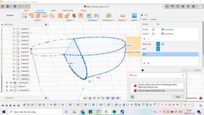

Hello, Im a student stuck on a surface loft.
I got the error/warning:
"Error: Cannot create surface from selected geometry.
Adjust the selection set.
Error: Cannot create tool body for loft."
This is only my second surface loft ever, so im correcting mistakes as I go (aligning points and such). But I can't figure out what the problem or solution is with this error.
The error appears when i select the rail, which by the way seems to be closed and connected to the profiles.
The other half works fine, so please please help me understand! Time is of the essence, huge thank you.

By the way I just tried using a centerline and the error did not budge. Please help 🙂
Message 3 of 20
jeff_strater
no one can help you without the design in question.  Export it and attach it to your next reply.  However, one comment I can make is:  you have way too many fit points in your splines.  No way of knowing whether that relates at all to the error you are seeing, though.

Thanks alot for responding. Okay exported and attached, I hope it was the right format. About the points in the splines, I projected a silhouette of a component i creating a pocket for. Is there a quick way to simplify the spline?

I took a different approach - instead of lofting one set of curves to the other, with one rail (which doesn't work , not sure why), I lofted from one set of curves to a point, with 3 rails:
(design attached)
But, that does not work with your design:
It will take me some time to explain all I did here.  The original design was messy.  Each profile had unnecessary lines in it, and as I said, too many control points.  It took some time to clean those up.  Look at my design in the meantime.  The resulting surface is not great - you'll want to clean that up as well.  But, the loft does succeed.

Here is a screencast showing what I did to one of the profile sketches to try to simplify it.  Repeat that on all the sketches involved.  You will have to be the judge of what is OK geometry, but in general, the fewer control points, the better.

I've gone through the timeline of your design and IMHO this is a complete redo from scratch starting with the first sketch in the timeline. It is not dimensioned and not properly constrained. It is also already overly complicated for the geometry you are creating. Fillets, for example, should not be part of that sketch.

I solved it, thanks for the help.
