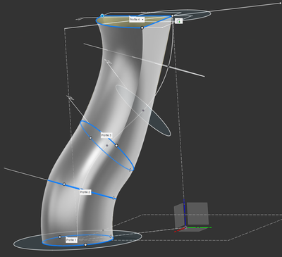

Did you find a solution to the 9mm thickness? Multiple lofts would also give me better accuracy, since loft from start to finish caused the adapter to become 5% too big in the middle.
Studies in multiple lofts:
A. Using all the ring to loft. At least is would make an interesting vase.
B. This one has potential. I had to skip the two last sketched rings before the quarter arc. But it has a little pot belly.
B. It loooks smaller but is also wider.
B. Still not satisfied with the shape. That pot belly needs to go! 😛
C.
This one has potential. And the middle ring is controlling the volume to not become too big. But something makes it arch backwards at the top.
C, Yeah, no...

Above are my attempts at controlling the loft. But it turns out that it has the more natural flow if I just loft the start to finish.
Message 126 of 133
joni_lundberg
I tried Stitch, but could not get rid of the yellow surface, and thicken did not work. Then I tried Patch on the open holes, and Stitch again, but now it is a bit too solid. Can't get it worse!
Back to the roots. Starting with the leg of origin. Create> Thicken. Then pick A surface of the leg - because after lofting a circle to a quarter cricle it will have several surfaces that are individually selectable:
Wouldn't that have been amazing if it worked... Now it it is full of jagged edges.
Doing the same thing again, but not selecting the three surface individually. My monster of a PC was struggling for 45 seconds, but we have a wiener!
Except, the hole imploded.
Interesting idea of thickening. 😄
It must be a bug in Fusion. I tried it exactly the same way and it worked.
Okay, I sort of knew it would not work to thicken and THEN use Circular Pattern x4.
Trying to thicken after circular pattern did not work. I think Fusion is saying that this is full of holes and will not work. So I should stitch, patch, stitch, and thicken, which did not work. Back to square one.

I think I was just doing a poor job stitching. This time it worked. All I needed was to stitch and then try thicken again, and it even created a nice solid body for me.
