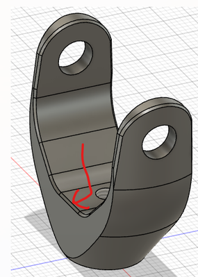

I am looking to model the part in the canvas tab. psi.75mm.CLVS
All relevant info is in the canvas tab.
I can not seem to create the lower radius that creates a circular form around the bottom part. I hope that makes sense.
If anyone can suggest a tip that would be great. Thank you.

Check back in a little while and I will demonstrate how to model the part.
Are you going to 3D print this, or are you going to machine it?

Hint: Think about cutting from stock out on the shop floor rather than modeling in finished form.

Lets start by placing and calibrating existing reference images in canvas.
Attach your progress file here for next set of steps.

Somehow you got the wrong scale in the Bottom View canvas.  You don't have to undo anything - simply Calibrate again and enter the correct dimension.
I have the final video recorded for modeling the geometry, but somehow I screwed up while editing out uhms and ahs and need to re-edit the video.  Going through the video edit I think that I have made the modeling process easy to understand.

As promised - here is a video of my steps.
Hey Fusion experts.
Anybody have an alternative technique for modeling this part?
@serviceT7GZW
If you are making manufacturing configurations, I recommend that you drag Extrude2 on the Timeline to occur before Extrude1.

Hello @TheCADWhisperer ,
First I would like to thank you for sharing your experience
I have recreated the model on my side with the help of your videos
I attach the screenshots that show the construction differences
Front view: the outside angle of 57° end with 1.039" dimension, the inside angle of 34° is not right because this angle is defined with 0.90" dimension and coincident points
Side view: I define the dimension 3.68" tangent to arc R 0.708" so chamfer angle is not 5° but 4.5008°
I ​​can say that I have progressed mainly with the intersect function

@user015M86YI was able to change the side view angles to 4.5° and bring the height to the correct dimension. I am not familiar with intersect function but it looks like I will have to learn that.
I am not 100% certain on what you mean " Front view: the outside angle of 57° end with 1.039" dimension, the inside angle of 34° is not right because this angle is defined with 0.90" dimension and coincident points."
