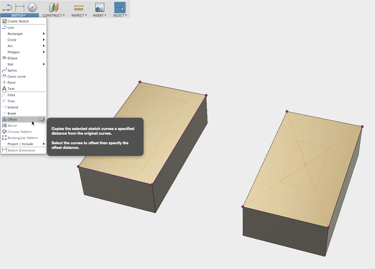

question 1. what is the smart way to get a grid of holes centered on a face? I eventually created a rectangle in sketch mode with a bunch of extra construction lines that I set to be equal.
Your approach was correct using sketches. there's a few of methods, however, to make this a bit simpler.
1.  the good ol' calculate method, effective, but prone to error.
2.  use offset curve to create your centered grid outline.  The mage below on the left uses this method.  I turned the offset curves into construction lines; you can toggle lines to regular/construction in the sketch palette (not pictured here).method1.png
3. Similar in principle to the offset curve, but a little more tedious (above image on right).  find the center point of the face then use a center point rectange to draw your grid box.
Once you have done this you can reference to corners for your four holes.  I would, in your model, probably not use the pattern for just four holes.
I made a copy of your model using some simplified workflows.  I'll make  avideo later today to show you what I did.

using the offset method i'm not quite sure how to wind up with a side that is a precise dimension? i.e. if one side of my starting hunk of material was 6x6 inches and i needed a centered rectangle of holes that were 1"x.75" I'm not seeing how to make that work...
but using the make an X on the material and use a center point rectangle I can definately see how that works for any rectangular shape
looking forward to the video!  really struggling to see how to add screws and align them to my empty holes... or how to get my bottom part of a clamp started.
