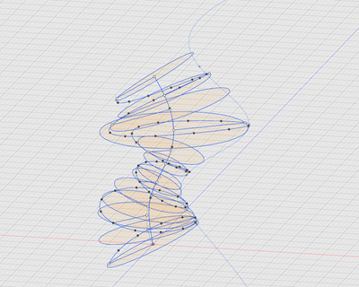

The purpose of this article is to describe the next step that is to give a pattern to the helix so that it is not a cylinder. The idea is to give the helix a variable shape as it goes up along the axis.variable shape helix.png
In this example the axis is slanting and the helix outside part follows a line that is not parallel to the axis and it is more slanting.slanted helix.png

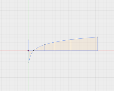

In the following example I have created a helix that starts from the same straight line (that is always slanting) but uses a generatrix that is a spline.
amplitude.pngThis allows creating a helix whose amplitude is “modulated” by the generatrix spline.
By doing this we make sure that as the helix rotates up around the axis, its radius changes its value following a line or a spline.

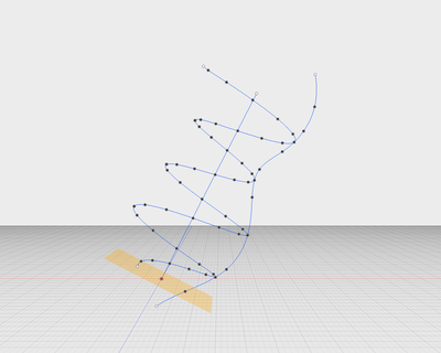

A circle with variable radius is drawn on every construction plane.
It's radius is calculated taking the distance between the axis and the intersection of the generatrix spline with the construction plane.
The construction planes start from the first point of the curve that defines the axis and stop at the extreme point of the axis.Define Curve.png
In the construction it is necessary that the generatrix spline is wider than the axis so that the first and last construction planes intersect with the spine in two real points.

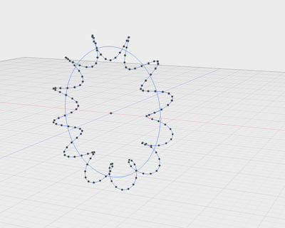

As a last example, here is the creation of a logarithmic spiral that starts from the projection of a helix that has a generatrix spline created by a logarithmic function.
I would like to know if there are other Fusion methods that can be used to simply create a logarithmic spiral.
