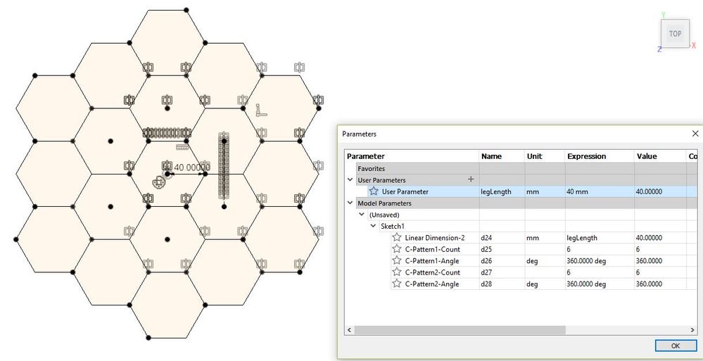

How about one user parameter, a couple of mirrors, plus a couple of circular arrays?
ETFrench

etfrench
Sketchup is Ok, but this is a Fusion 360 forum 😀  Where are you having trouble doing this in Fusion 360?
This was done with just one parameter with several joints and a couple of circular patterns.  It's not a difficult task if you think in Fusion 360 terms instead of Sketchup terms.
ETFrench

etfrench
Here's one way to do it with joints.  To do it in a sketch, then you can just copy/paste the three hexagons needed for the circular array, however, when it comes time to extrude, you'll either need to do a lot of trimming or selecting small closed boundaries.
ETFrench

etfrench
Here it is with just a sketch.  It is rather tedious to add all the necessary constraints to make it parametric.  Still only 2 parameters, one for the size of the hexagon and one for the wall width.
ETFrench
