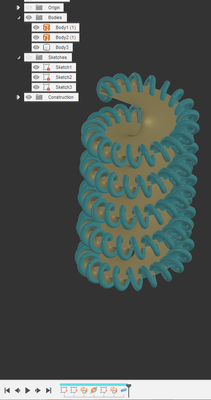

I would like to make a coil, and somehow 'sweep' it down a path which is another coil.  Obviously sweep isn't the command but I wanted to give you an idea for what I'm trying to do.  Is this even possible, a coil within a coil, in F360?

How do you make the smaller (longer) coil follow the path of the larger coil (shorter)?

Is the shape you're looking for what you'd get if you took a long spring and wrapped it around a cylinder in a coil?  If so, I have an idea, but I want to make sure that this is the shape you want.

Not sure why @C.FOTI  started another thread but I answered in this thread with a couple of example files.
https://forums.autodesk.com/t5/fusion-360-design-validate/coil-onto-a-helical-path/m-p/10207654#M244...
Done using sweep in the patch work space.
