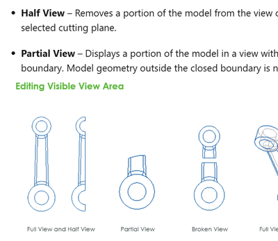

For a symmetrical part it is space saving to have a half view (with centreline) to save space on the drawing sheet.
Am I missing this option in Fusion or is it a case for another work around?

percyengine98
No, looking for a symmetrical/half view like in Creo:
johnsonshiue
Hi! There isn't an one-click View command to do that in Fusion at the moment. You may need to create a section view and then create a projected view from the section view (check "Inherit section" option).
Many thanks!
