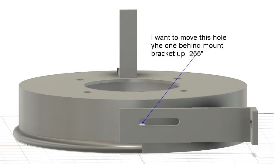

Now I have a hole to move it seems to not move the same way, can you assist me in moving a hole up a bit?

jhackney1972
Do not understand the question.  Please attach your model for assistance.  If you do not know how to attach your Fusion 360 model follow these easy steps. Open the model in Fusion 360, select the File menu, then Export and save as a F3D or F3Z file to your hard drive. Then use the Attachments section, of a forum post, to attach it.

jaxbuddie
Please don't be offended. lol. I am sending you just a piece of my file. but showing me how to move this hole will allow me to move any holes. Thank you.
Message 15 of 19
jhackney1972
The main thing to remember is to place the hole in the correct position in the first place.  In the video I demonstrate two basic methods of doing this.  I also show you how to move a hole but this is not recommended, place it using an established method and then simply change the location dimensions.

jaxbuddie
Thank you, I'm still waiting for your last video to load, but wanted to say this, the hole I'm wanting moved was mounted in exactly the right place at the time I punched it but because you showed me how to remove half of my torus I moved the bracket up .255" so I could move the bottom bar up. lol. Thank you so much for your teachings. You are great at this.
