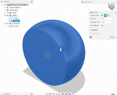

Hello @paul.clauss ,
I have tried to use this technique in order to get structural properties of the remaining parts, i.e. mass, moment of inertia, etc.
I would expect these to come about, since I have a material assigned to the sphere and the selection filter is 'bodies'.
This however is not the case, I actually get no results.
Could you please advise a way to go about this?
