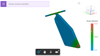

I am trying to obtain a generative design model of a bicycle frame, but the study doesn't create any solutions cause i get this error message:
The preserve geometry and forces are the following:
And this is a section of all the geometries:

Hello, to solve the issue go to the study settings and move the mesh size to the tight region.
That will allows you to get the results.
But I will also look into the loads, probably you are applying too high a force becouse the first shape has a safety factor above the limit.
BTW if you have that high volume of obstacle volumes, draw a initial shapes, it is always easier for the software to mesh it later.
