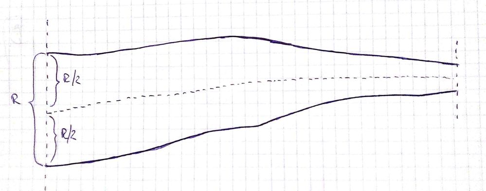

I am designing a lightweight reinforcement and I would like to add rounded cutouts to it.
The situation is following - In the picture there is a side-view of the body (solid).
I would like to add perforation (cut holes) as it is on the second picture:
The circles have to be in the centre of the target body with constant gap between each circle, its size adjusted according to the target body.
My idea was to create first cutout in the centre of the target body and then use pattern command to generate the rest of the cutouts. The thing was that I was not able to make the cutouts dynamically resize to match the size of the target body. The all cutouts were the same size.
What is the correct workflow to achieve this in the Fusion 360?

TheCADWhisperer
Are the edges for distance "A" arcs and lines or are they splines?

TrippyLighting
It's not difficult to imagine what the end result is supposed to be, however the question is if the curves are splines or a combination of arcs and lines.
If you used arcs and lines this is relatively easy to do, however currently splines in Fusion 360 do not allow for a tangency constraint to a circle, which makes it tricky.

TheCADWhisperer
From that image it appears the answer would be splines.  Oh well, you are going to have a lot of construction geometry.

The edges are splines.

This is as close as I can come.  It's not perfect, by any means.
First, you will need spline fit points everywhere you want a perforation, because you can only dimension to a spline fit point.  Also, you cannot, today, dimension to the tangent points of a circle (coming, soon!), so you have to do some math to get the spacing between the circles and the splines:
Model is attached.
