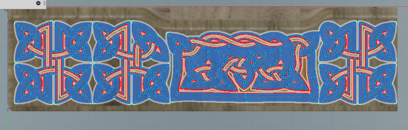

I have an extrusion of a fairly complex SVG, that I'm trying to do a combine with. However, one of the bodies (Body21) fails and gives me the error:
"Compute Error: General modeling error"
Searching has returned nothing. Any ideas what's causing it and how I can fix it?

I took a look at your file and I noticed that there was an issue with the extrude of the SVG file that you created.
You can see in the timeline that the sketch is showing a warning and if you edit the extrude feature next to is an error message comes up.
I deleted the extruded part and re-extruded each of the knots separately, that seemed to help.
Then I combined each of the knots one at a time in to the body below them.
The tree "round" knots all combined with the lower body but the rectangular knot wouldn't.
In the image below the red knots are combined with the body but the yellow body will not combine.
I'm going to give this file over to the development team to take a look.
