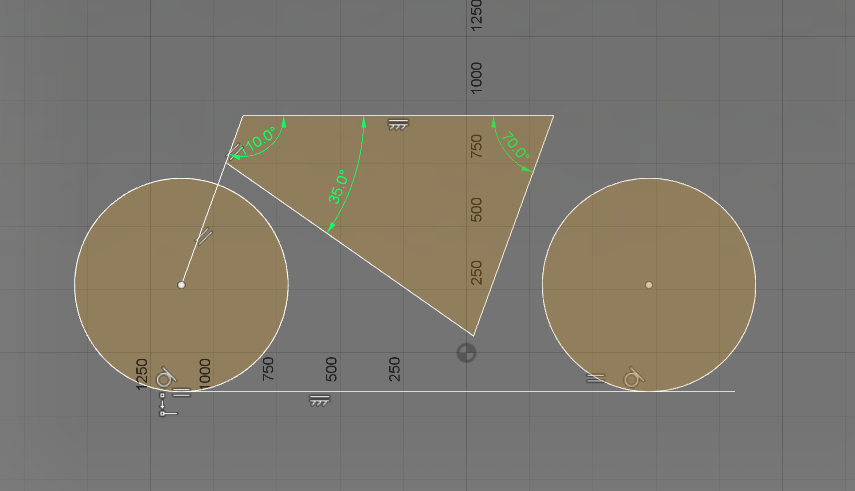

I'm doing a test trial with Fusion 360 and cannot figure out how to align the different tube components in this rudimentary bicycle I am trying to model.  See picture below. Any suggestions?

haughec
Hi Emil,
Can I ask how you created the model?  Were the components created using primitives, or did you first create a sketch?
If your goal to precisely position the components to one another (specify distances & frame angles), the best way to do this is to start with a sketch (as in the attached image).  This will allow you to specify the frame geometry, and then you can build the components from the sketch - already in place.

Hi Charles,
Thank you so much for your prompt reply and suggestion.  As far as my workflow, I just created separate sections of tubes or pipes and eye balled them together, pretty much how someone would try to cut pipes and weld them together in real life.  This is probably naive in my part!  I am an electrical engineer by trade but with a strong interest in the cool modeling tools available today.  This is especially more so since the past two years I have been a mentor and sponsor for the First Robotics Competition where 3D modeling of the robot prototypes can be of great benefit which has peaked my interest and determination in learning and sharing these powerful tools with our youth.
All this being said, I am not from the CAD/CAM or mechanical engineering or drafter side of things.  I am not sure how I would be able to extrude these pipes out of the flat sketch layout you have shared with me.  I was hoping that I could stretch or change the tubes at will, change the angles between them but yet have them aligned within a flat plane like a bicycle frame would be.  Sort of like one would cut pipes to different lengths and affix them to a frame or jig to fix the relation between them and then weld them together.  Would I be able to use the tube sections and superimpose them on your sketch and use the sketch as a jig to change the relation between the tubes.  Is there a way to achieve this with constraints?
I have noticed as a novice that when one uses tube sections in 3D modeling things can get rather challenging because there are no edges to snap or align.  In this case I would intuitively think than then centerlines would do this function, but apparently they don't.  I am confused with the "construct category" which seem to work referentially but I cannot actually use them to "construct" the frame sections.

Oceanconcepts
Emil,
Let me throw in a couple of thoughts from another user fairly new to Fusion.  The aligning of bodies seems to be a common point where we falter, as Fusion has a rather unique approach.
It's best if you make independent parts into individual Components. If you, like me, are used to being able to select the center point of a torus like your wheels and just snap them to alignment, it's odd that you need to create that point in Fusion.  But there are some advantages.
If you activate the Component for a wheel in Fusion (the little circle/ radio button to the right of the component in the browser) then in the construction menu make a "Point at Center of Circle-Sphere- Torus" , and do the same for each wheel (activating the components in turn), you can then select these center points (after making the root component active) and use the align command (right click to bring it up) to put them together- you can then use the move tool to slide them along any axis you chose.  You could do the same for the cylindrical sections of the main frame.  The key is creating a construction element to relate to the component.
The general principle is to make a reference construction point or plane(s) in each component that you can use as a kind of "handle" to align them. This can involve some creative thinking, but it can also be kind of powerful. If you make an axis for each wheel-component, for instance, and align those, the wheels will be side by side.
Using the Joints command is another way to align parts, but in your case another approach is probably better.  There may be MUCH better ways of going about this, I only suggest things that have worked for me.
Thought to add that you must be sure to select the Move Components" option when you want to move the entire component and its associated construction elements. Fusion asks you to be aware of what elements are associated with a component, as opposed to being at root level.

Hi Ron,
I have been reviewing your instructions, and trying different iterations of it wih no success :-(.  BTW thanks for your feedback.  I am trying to bring up the align command after creating a point and I can't figure out how these are supposed to snap together.

Ron,
You ROCK!  I finally got it to work, by trying your instructions over and over until I finally saw the illusive ALIGN feature.  BOY, that is the toughest thing to figure out in 3d Modeling programs, these contextual functions that only appear if you click on the right portion of the component, with the correct shift-clicks, right sequence of events and BAM, then it works.  This ALIGN feature should be explicitly mentioned in the Fusion 360 document.  Thanks a million!

haughec
Thanks for detailed instructions, Ron.
Emil, I'm glad that the Align Components command is working for you (now that you've found it).  I'll look into making it more discoverable.
