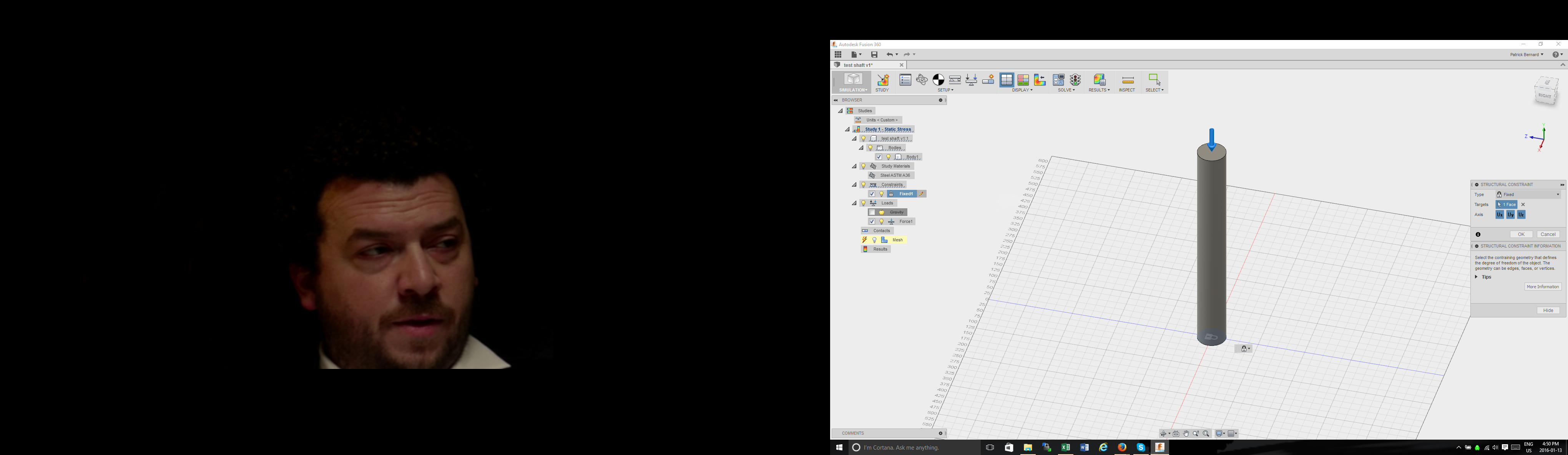

edid: I also try to put force downward on the axis of a shaft and I get the same error.

Hi patcbernard,
Can you please attach an image that would explain us how you have constrained and loaded the model. Thanks!

Hi PatcBernard,
I could solve or your step file.
This is a pretty simple model/study that fails for you..Looks like nothing succeeds?
This could be a permissions issue...can you please attach the diagnostic file to this thread? Thanks!Screen Shot 2016-01-13 at 4.57.38 PM.png the diagnostic file?
