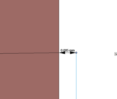

not exactly sure what your trying to do.  one thing I see is that your profile sketch isn't actually on the face of the object-
minute errors like this will eat your lunch when trying to do things in fusion.  there's to much going on in the model for me to tell how it got like this.
also, the edges you're proposing to use for the sweep are made of many tiny little segments, and have horrible curvature quality.  that will be problematic also.-
