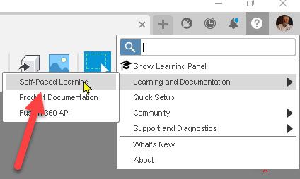

You can get some free training by using the Self-Paced Learning tutorials furnished with Fusion 360.  The screen capture shows you where to get started.  Remember, the Forum is here to help, there are lot of knowledgeable users willing to help with your questions.  Remember to always attach your model if the question concerns it directly.  This will speed up your replies.
