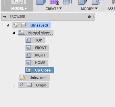

Hi, David,
Have you tried using the named views feature?  (If this isn't what you were talking about, just let me know).
It allows you to save a zoom/angle of the view and you can return to it any time.
Whenever you've got your view where you want it, right-click the "named views" folder at the top of the browser, and select "New Named View."  It'll show up in that folder, and whenever you click on a named view, it will bring to the camera to that position.  Once it's made, you can name the view by clicking twice on it (as opposed to double-clicking).
Screen Shot 2016-01-04 at 11.04.47 AM.pngScreen Shot 2016-01-04 at 11.05.06 AM.png
Is this what you were asking for?  If not just let me know and we'll figure out what you need.
