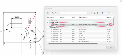

I am trying to calculate the length of a line. It is composed of arcs and circles.
I cannot get the a formula containing degrees to enter correctly.  Not at all sure why.
Is there a way to do this??
or better yet an easier way to do this.
see attached file; sketch 4.....the line is the curvy construction line

just selecting multiple curves will tell you the total length without doing anything else.  it displays in the lower right corner-
but-
@jeffescott wrote:...i hope i can use it parametrically!
neither option shown so far will be parametric.  your original approach will work if you get the formulas right. you're probably not canceling units correctly.
there also may be a different/easier way to achieve the end result you want, but we don't know what that result may be.
Message 7 of 14
laughingcreek
here's an approach using Sheetmetal to get the total length of the line in a parametric way. see attached.  these are the features added to your model to do this-
the process will yield a dimension that reflects the total length-
plus side of this approach is it will work with splines also.

thank you doh radians
Message 9 of 14
jeffescott
yup that is the way.....I am designing a serpentine spring.  I need to iterate to the length with my spring program.   I quickly get confused with all the variables...this makes it much simpler.

So my issue with manually in a user parameter.   I can’t find a unit equal to mm4.
so i tried no units it works.  Is there a better way
