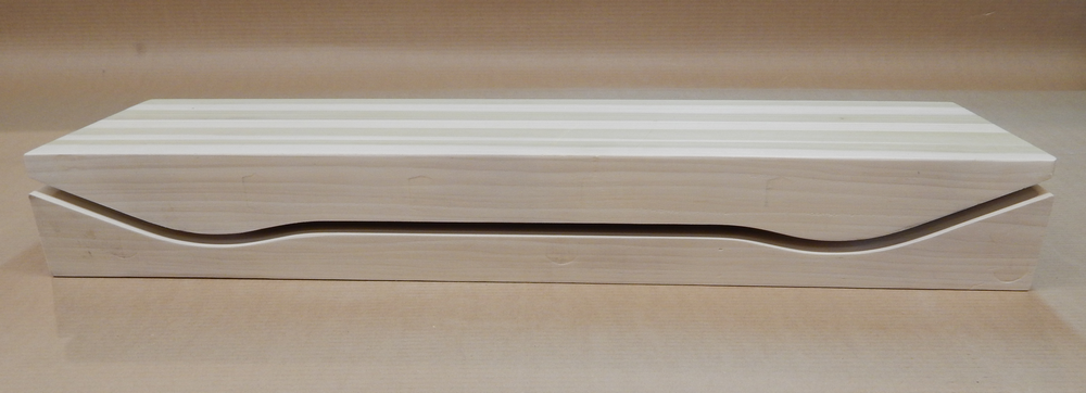

Hi guys,
Right now I have this skateboard modeled up really nicely. My problem is that I intended to use it to form a 2 part rectangular mold with the drill holes included. I've been having trouble getting boundary fill to work and for some reason using combine+cut doesn't work for me.  Any tips would be greatly appreciated! I've attached the final skateboard that I've created. What I'm trying to do is essentially create a mold like this.
http://www.pushmorelongboards.com/popcycle1.png

lichtzeichenanlage
Perhaps this tutorial might help you:
Message 3 of 10
davebYYPCU
Same as the video, but not as elaborate,
used patch Offset, Patch for the holes, and a Sweep.
Might help....

seandee99
Woah, thank you so much! This was the solution I was looking for. Thanks!

davebYYPCU
Ooh, I never measured it, but was going to comment that the "finished board" has no draft yet,  and sketches were not constrained, but forgot when writing the post.
Message 8 of 10
seandee99
I plan on using extremely thin veneer. This was just for getting a mold for pressing blank boards. I wanted to print a mini test mold to get a feel for the shape before I go all out and get a full-sized one machined.
