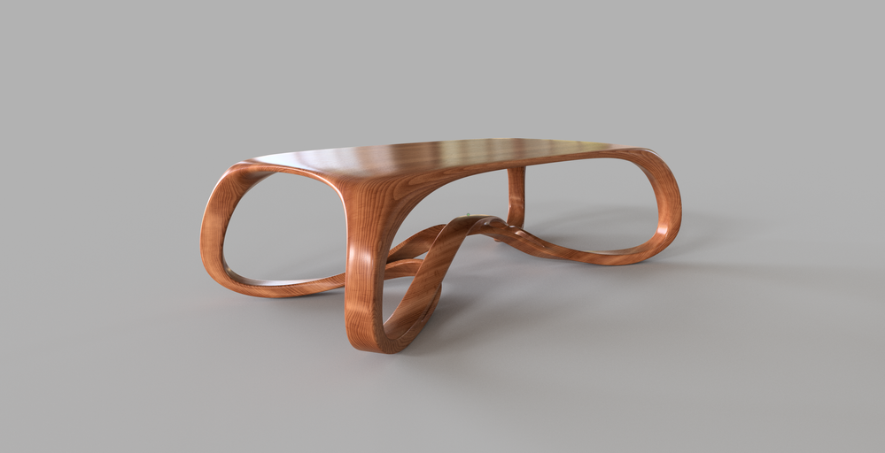

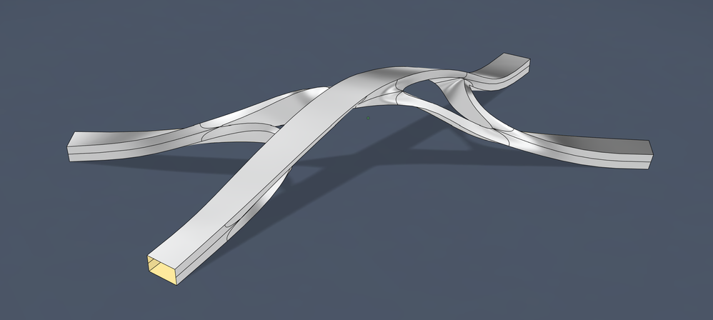

I have a model for a table that I quite urgently need to present. My 3d model is still very flawed but the smoothing function does not work as i want it.
The 2 legs that sweep and twist underneath should look the same from a side view (looking at the twist) but from a front view I want the 2 sweeps to come together and then separate again.
I attached how i want it with some veneer strips to give an idea. And also the flawed model where the connection is not yet made.
Since i need to model it urgently, all help is very welcome.
Thanks in advance.

Ultimately, the model needs to be brought into Fusion so you can machine it. Is that correct?
I have exported the low-poly version of the last design I posted. You could try to make the minor modifications in Fusion. I'll then fine-tune it in Blender.
Does that sound like a reasonable approach?

I made a first attempt at a completed model:

Thank you. That is starting to look great.
I don't have good internet access so will get back to you when I can open fusion. But much appreciated !
